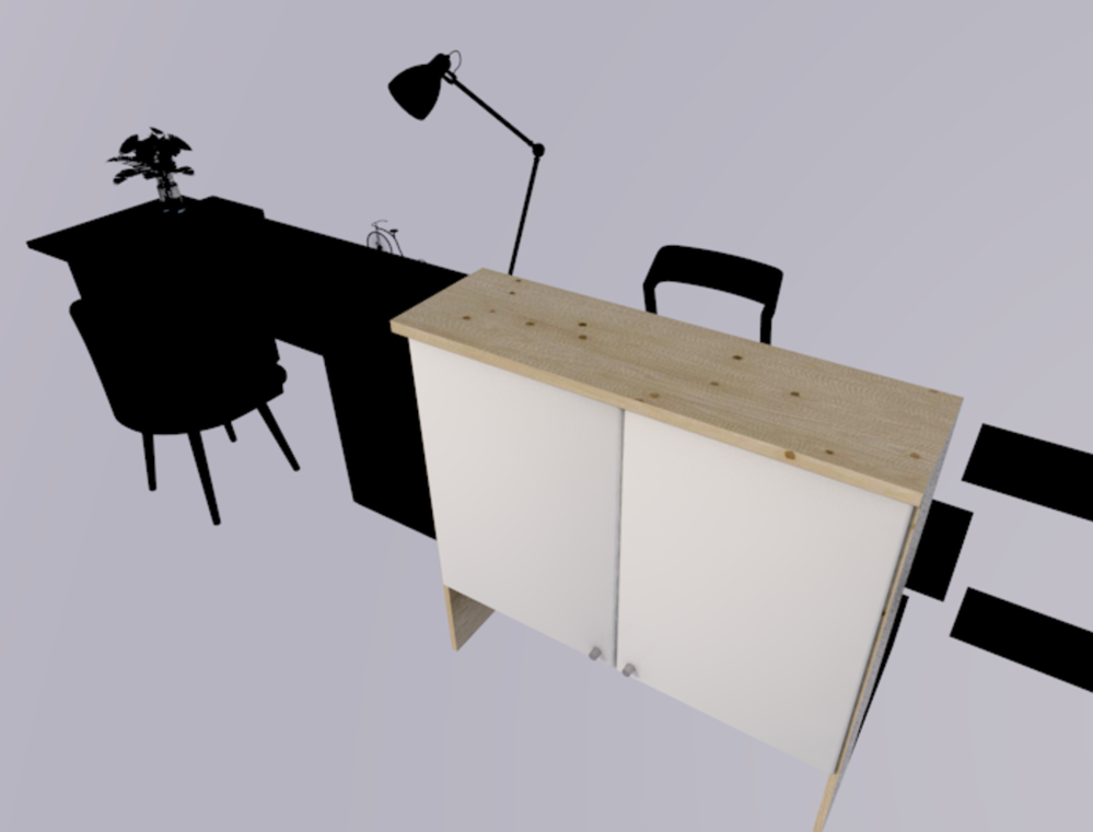

Hello, I use speckle to transfer a componet from su to archicad, and it rendered black. Is there an option to transfer the texutures as well? (the dinner side table is native archicad object, it is right)
jsdbroughton
We are slowly building support for textures but none is implemented yet.
More than any other data point softwares handle textures in very unique ways per app.
Funfun Yan
OK then, but can the model be some solid color if not texuture than the all black block?
jsdbroughton
This should be the expected behaviour. I’ll log this as an investigation ticket to check why not.

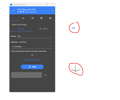

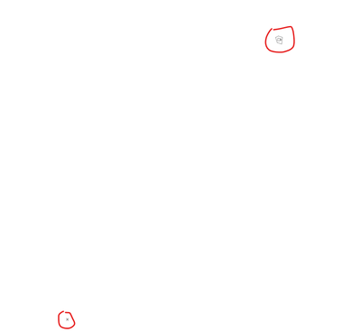

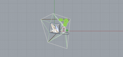

JSN
Ok, for now will leave the information here as I solely have screenshots at the moment.
This is an example setup where the model is located not close from the origin but also not too far away ...
... and while an IFC for example which is exported from the AC Origin appears to be correctly referenced in Speckle is the direct stream from the AC not ...
... as also this received stream in Rhino demonstrates ...
... but just realized it is only for this special file as a fresh test file where I only copied some elements seem to be correctly positined
... so is there a setting / user coordination system / ... I don't know, anything which has an impact on the location in the original file?
Thanks a lot!
Edit: Ok, probably ran into that bug?

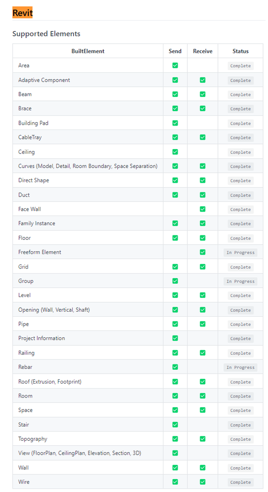

Is this the most recent element support status?
Civil Engineer, Enviromental Design MSc. BS ArchitectsVR.
Graphisoft Insider Panelist-Archicad 29. Windows 11. Intel Xeon 2699x2,64 GB RAM, Nvidia ny or personal website3080Ti. 2 Monitors.
Tuan Tai Truong
That's screenshot from speckle docs. @lyur said it's outdated. May be it is.
Supported Elements | Speckle Docs
@lyur: We are still talking about two different things. Thanks for the info. I will not be working in Revit and will just focus on communicating with extern using speckle without translating exactly element to element. Good to know it will map that way. Speckle is working on it so I guess I can wait.

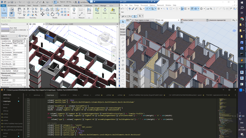

Speckle connector's development is mostly focused around Autodesk Products (especially Revit) and Rhino. However, these tables are slightly outdated, the last releases have added a lot of new features (except GDL that is still not available). The most useful addition was exporting properties and tool's parameters for each element. The output schema is pretty rich.
But for me is more valuable mapping possibilities. It was firstly introduced for Revit/Rhino connection, but it could be applied for other software as well (well, with some coding workflow though). I'm working with python to override the speckle scheme coming from Archicad in more suitable way to be undestandable by Revit. So I could transform, say, Windows to exact Revit window families and types from my template.
If you interested, I could show the process.
