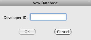

AddOnAdmin has two functions: managing a database of generated add-on identifiers and checking the status of existing add-ons. With the Database function selected, click the "New Database" button and enter your four-character Developer ID that GRAPHISOFT sent to you.

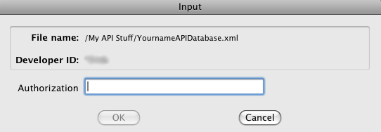

Next, select the Developer ID entry in the database window and click the "New Addon" button. You'll get a dialog asking for your Authorization code, which GRAPHISOFT would also have sent to you with your Developer ID.
