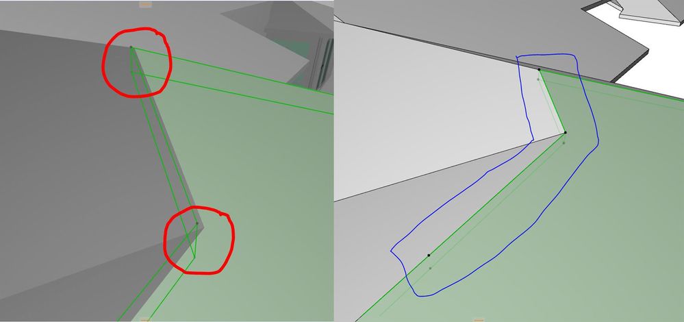

Dear All,
I am currently using AC 19, when i open 3D window my view got problem ( with hotspot and contour line is not stick together as left side in my attachment ) but i copy any item to new file it's work normaly ( like right side in my attachment)
If you have any experience about this bug please help me.

Are these elements by any chance very far from the Project Origin? That could cause inaccuracies.

i think it's not a reason , my project origin is right beside my model ( as pic )
Thanks for you answer, i will upload the corrupt file , if you have time to open and take a look , i am very appriceated
https://mega.nz/#!d8AxGKRQ!fO8XxlJoZtjKrW5d9jtevYK6jBfZtR1yiHEu1oWUhU4

I checked the file but I have no problems in 3D with the location of hotspots and selected edges.
I am wondering if this may be graphics card-related. Try to upgrade to the latest graphics card driver. If that does not solve it then I have no further ideas.

I too don't have any 3D problems with the file
Thanks guys, i think my display card 's issue.
