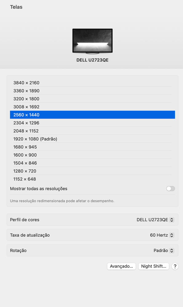

Vinicius Lima
Hello Karl, thanks for your answer!
But my setup its working well since I answered the topic above. When I was trying to fix the problem, I found this option "High Speed Data" prioritization in the monitor menu as well, and set it just as you said. By the way, my monitor is exactly the same of yours (U2723QE). Using 3008x1962 with 60Hz, and its working smootly. Maybe I've changed to much settings, and the Archicad was only able to work fine when I restarted it.
PS: I tried to put on 2560x1440 resolution, with refresh rate of 60Hz, and it's avaible for me, and works fine too. Double-check it  (take a look on the print-screen attached).
Well, good thoughts guys. Thanks a lot!
