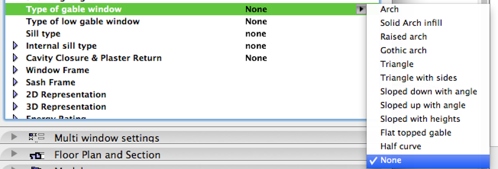

I got my Retina MBP today and as stated, the screen is amazing. The text in ArchiCAD 15 looks like text on paper. But I just noticed that pop-out selections in parameters do not work.
The work around is to select the ArchiCAD application from the ArchiCAD 15 folder, 'get info' using command 'I' then tick 'Open in low resolution'. When you start ArchiCAD, text now shows blurry but the pop-out selection lists will now work. Note : This is in 'Lion'. The Archiwiki entry states this as being in 'Mountain' Lion only.
This screen show show what the pop-outs look like with 'Open in low resolution' ticked. Without it ticked, you get zip.

Just tried it your right. That's a real shame though, because as you said everything else looks amazing.

Interestingly, this issue doesn't effect the pop outs when using on an external display, even when ArchiCAD is in 'High Res' mode. If you drag the dialog onto the Retina screen it stops working, if you drag it back to the standard screen it starts working..
just tried it and you're right, very odd.
