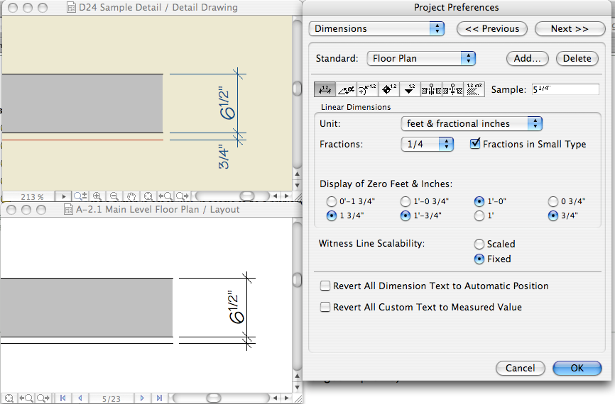

Has anyone else noticed this? A coworker discovered this bug and I can confirm it on my Mac with the newest build:
Dimensions displaying fractions less than one inch do not show on the layout or print if the Fractions in Small Type setting is checked and last radio button is set to 3/4". It seems to be a problem displaying the small text alone because if either of those settings is unchecked, or the value is large enough to contain large and small text, the display is fine.

Yes (right after I read your post). It doesn't seem to matter if I have 0-3/4" or 3/4" checked. I'm on US Build 815 full.

Update. This has been reported to GS Tech Support and assigned Case 075739. I received this from them today:
Graphisoft wrote:
Geoff:
This bug has been acknowledged and will be fixed in a future hotfix. We apologise for any inconvenience.
