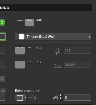

Hi, I recently installed AC29 (build 3100 INT FULL) on a mac mini with M2 pro and OS 13.7.8 and the icons on the elements settings appear truncated like in the screenshot
Any ideas how to fix this?

Yeah, by updating your macOS. 😅 You are four versions behind – Graphisoft only supports two back. So right now that would be 26.x and 15.x.

Well, I did update my OS to the newest version, and I still have the same problem
On other macs in the office that have the same macOS version, the problem does not appear...

Is it a dark mode issue?
That looks like you have dark mode on?
no, it's not. I tried the standard mode and it's the same
Mac OS 26.1 | AC 29.0.2 INT 3200 FULL

That’s a weird one. We’re using 29 on MacMinis with M2 and M4 and haven’t seen the same issue.
Do you have a non-standard screen resolution?

Wouldn't say so.

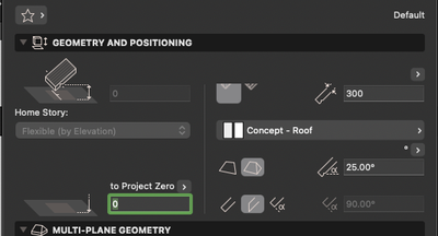

Did you find a solution to this? I just got round to updating and am having the same issue.

 I have just updated everything and it seems certain element settings, and the standard toolbar are affected, others seem fine.

When I change the mode to "Light" on system settings the images appear OK. Then I change AC work environment to match my device, turn the mode to "Dark" and the icons appear OK
But then, once I quit and reopen AC everything goes back appearing truncated...
