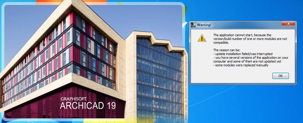

Hi, can somebody help please with the warning attached image?
I did all the updates but I still get this warning every time I start Archicad 19.
I have also installed Archicad 17 & 18 and everything is updated.

Try to reinstall ArchiCAD or uninstall all other versions and first intel the latest version 19
this message could come with a Cadimage plugin and the last AC Hotfix.
check for updates at Cadimage.com, they know this bug.
