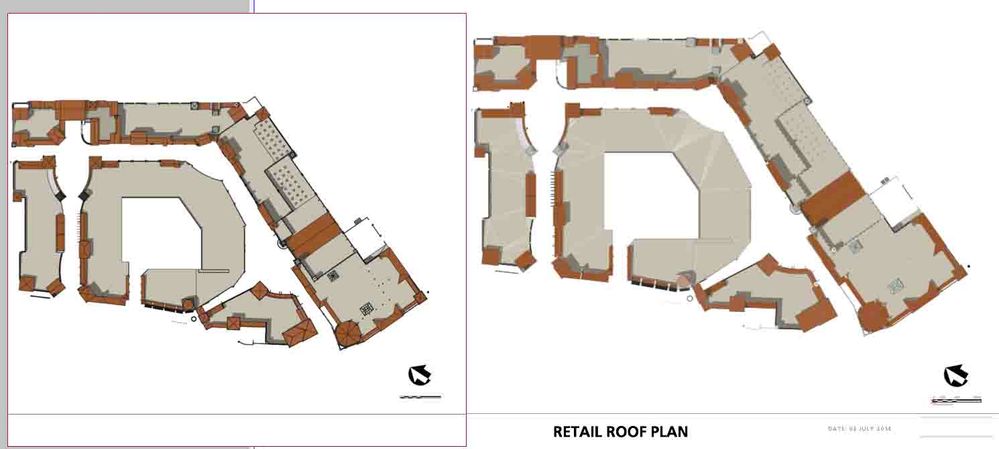

My v18 installation is not printing text to pdf. Is it known if this has happened to others?
On the screenshot you can see that v18 pdf prints no text while with v17 prints fine.

Eduardo,
yes, we had a few reports about this problem. We are in touch with Adobe to have this resolved. Please find all details and possible workarounds here:
http://helpcenter.graphisoft.com/troubleshooting/import-export/text-missing-in-pdf/#Printing_issue_f...
