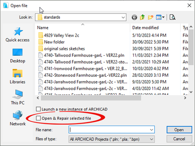

Is Archicad crashing before you try to open a file?
Or will it let you open a new file from the template?
If it is only this particular file that crashes, try to open it with the 'Open & repair' option selected (from the FILE > Open menu in Archicad).
