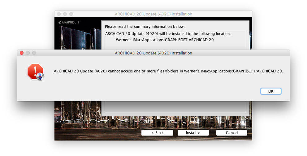

I have a problem installing AC20 Hot fixes... Please see screen shot below.
Any help will be highly appreciated.

Werner:
Try this: go to Applications > Graphisoft and select that folder, then Get Info (Command-I) and change Sharing & Permissions > everyone to Read & Write. Change this setting back after running the installer.

Thank you very much David.
This helped!
