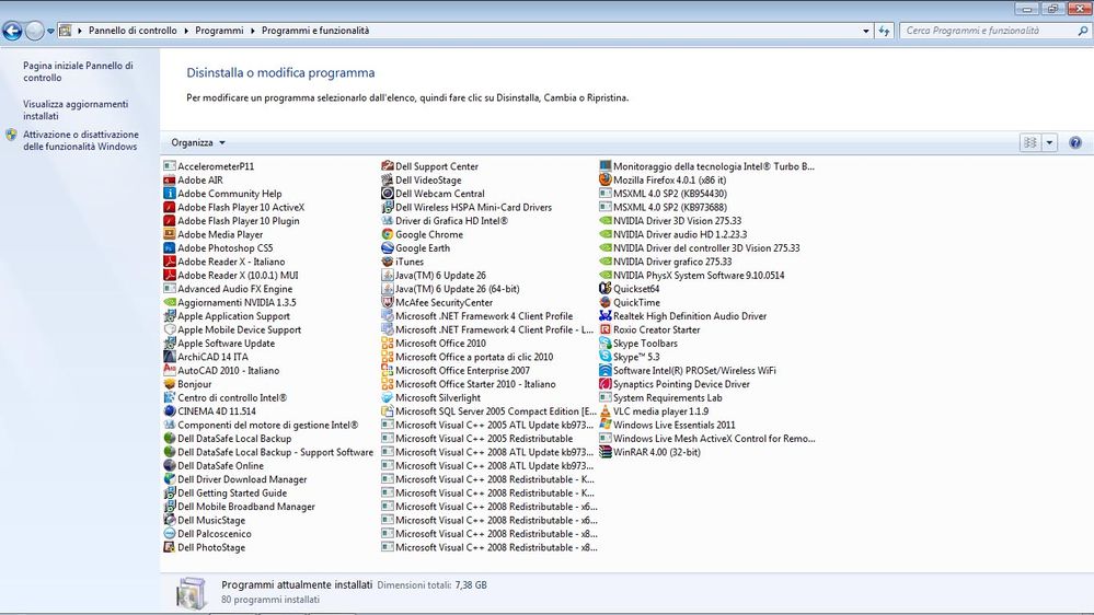

Can you post a screenshot of the full list of programs installed on your computer?
Do you mean a list of the active process in the task manager?
I mean in the Control Panel, there is the Program and Feature Dialog which lists all installed programs.
I want to check if I see any suspicious program that may interfere with ArchiCAD.
Here you are.
I would first check those Dell Datasafe programs, and also the McAfee virus protection software.
Try to either uninstall these or end their processes in the Task Manager, see if that makes any difference.
No I'm sorry. It's the same...
I'm out of ideas.
You should contact your local reseller with the report so they can handle it.

The only other thing that I can think of is do you have full read and write permissions to all of the Graphisoft program files?
The fact that you can start in safe mode makes me think as a user you have different permissions.
