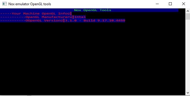

Graphisoft Staff Product Manager
I checked, says OpenGL 3.1.0
