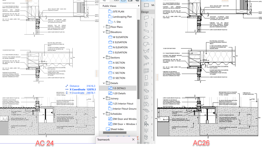

Has anyone solved the issue of ArchicCAD 26 displaying with 'fatter' lower resolution linework than earlier versions on same workstation (i.e. same hardware, same Windows version, same graphics driver etc) ?
This is with Archicad 26 version 4019 and using same 'Advanced Redraw Options' settings in Archicad 26 as with Archicad 24.
The consequence is that adjacent linework in detailed areas visually merges together into a blob far sooner than it normally does when zooming out, and small differences in line weight are hard or impossible to distinguish.

OK, I have a workaround from Central innovation (my local reseller):
If I'm guessing correctly from your description, then your monitor is set to the recommended display scale too, which differs from 100% (125% presumably). If I'm correct then it is a known issue, you might want to refer to as DEF-11369. Unfortunately, there's no scheduled fix for it yet, but hopefully, it will be handled as soon as possible. The latest feedback from development is that the error seems to be that fills don't take into account the scale factor of the display.
There are two possible workarounds:
- use a 100% scale (it should be fine)
- or revert to the legacy rendering in the Registry Editor
This latter option can be achieved by opening up the Registry Editor app. Then follow this directory path to reach the rendering setting:
HKey_CURRENT_USER\SOFTWARE\Graphisoft\Archicad\Archicad XXX\Graphix\RenderingAPI. ('XXX' refers to the currently used AC version and language.)
Double-click the RenderingAPI registry line and type '-1' as Value data. This should revert back the rendering engine to the previous (25) version. Please be aware that if you change this setting, then you will have to change it back manually to '0' when an update or fix would be implemented regarding this issue.

Can you attach a few screenshots so it is easier to see the exact problem?
Paul King
Mentor
A side by side screenshot is attached showing same project open under Archicad 24 vs Archicad 26.    You may need a large 4K monitor to really appreciate the difference - which is possibly why the issue was allowed to remain unaddressed for so long since it was first reported in Beta testing (how large are the monitors used by Graphisoft developers?)  - but of course those of us working in front of large 4K monitors are forced to 'appreciate' the difference all day long.
