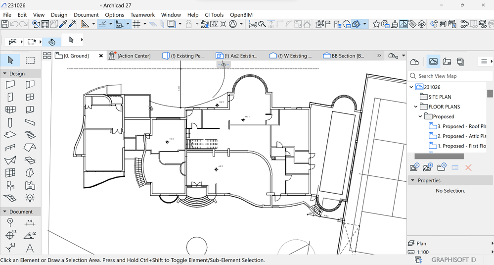

It goes beyond looking blobby and blurry, linework doesn't even connect properly. You need to get an accurate display of your 2d drawings to be able to work effectively.
If display scaling were to work correctly, then the drawings should look same regardless of what display scaling you have set Windows to. This is the case with the old drawing infrastructure. If you set display scaling to 350% for instance, then that really demonstrates the problems with the scaling. I have attached an example.
And no, it is not valid to say "well 350% is set too high". The point of this exercise is to clearly demonstrate the erroneous scaling behaviour and it should be easily reproducible by anyone using Windows, regardless of display.

Attached is a screenshot from AC28 at 350%. Turning off view true line weight did not affect appearance much here. It's definitely still bugged, though the performance is inconsistent.

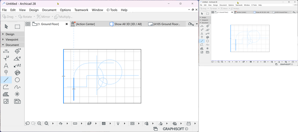

Paul King
Mentor
Hi Laszlo
Side by side screenshots below.  True line weight is off.  Larger image is 350% display scaling, smaller image is my standard 175% display scaling.
Essentially, the 350% screenshot on the left looks like the line weights are being scaled up as well, not just the application window text & icons.  Ditto the polygon resolution of the curves. (may be hard to make out the 'curve' vertexes unless you view image at full size, preferably on a 4K 50" monitor - please ensure your developers all do have monitors like this, otherwise they may not recognize the problem)
While I am personally happy at 175% scaling, the reason people might need 350% is not because they can't see the line work unscaled, but because they can't make out the application window text and dynamic feedback/ cursors etc unscaled.   The app window content itself should be left unscaled by default (though a separate display scaling control for content line weights might be useful for really huge monitors where user or their intended audience in a presentation sits very far away from monitor)
This issue will only get worse as people migrate to 8K 70" monitors (remember when we though 14" was extravagant & unnecessary & would never catch on? 🙂 )
