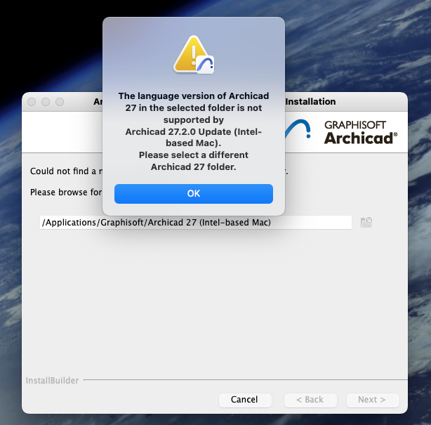

have the same issue with crashing and this is what i get trying to install the update
even after selecting the folder where ac is located.
‎2024-05-06 04:22 AM
Seems you are trying to install the wrong language version.
You are USA language, you may be trying to install the INT update.
Make sure you are downloading the USA update for Intel Mac.
