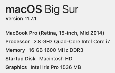

Bit more info following on from my previous post (‎2022-12-19 11:28 PM)This time using my 2014 MacBook Pro (INTEL)
same file GRAPHISOFT_Archicad_Sample_Project-S-Office_v1.0_AC25.pla” using the Australian version of Archicad 26 build 4019
Default 3D window, default Photorender settings using Standard 4min 46sec (compared to 3min 07sec on Mac Studio MacOS 13.1 above)
Default 3D window, default Photorender settings using Redshift. Redshift not supported by previous OS "Big Sur"
Times to open project 2014 MacBook Pro:- 29 sec to library dialogue 55sec in total
Times to open project Mac Studio Max:- 15 sec to library dialogue 26sec in total
Times to open 3D widow 2014 MacBook Pro:-7.25 secs
Times to open 3D widow Mac Studio Max:-4.07 secs
All times are approximate.
