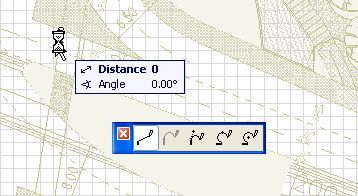

hI
i HAVE A STUDENT VERSION OF ARCHICAD 16 64 BIT
AND AFTER i CHANGED IT FROM 14...WHEN i DRAW FOR INSTANCE
A SLAB WITH PLYGONAL DRWA METHOD : LINE---ARC---LINE
THE SMALL WINDOW TAP DOESNT SHOW UP ANUMORE DURING DRAWING...
THE ATTACHED A PHOTO....HOW CAN I FIX IT?
1 Reply 1
What do you mean by "Window Tap"? The Pet Palette?
I can think of two things:
1. Go to the Work Environment Dialog and set it back to Standard Profile. Th Palette positons may have shifted and this would reset them back to the default settings.
2. Try to update you graphics card drivers. It may be some driver issue that cuases you Pet Palette to disapper.
