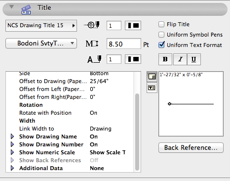

Ok, one more for you guys. I gave up on our cutsom Drawing Title Block and am trying to tweak the NCS_15 on. Turns out it actually works quite well with little effort, but I am running into one little problem. I can't seem to change the text font type from the default one. Basically all options for font type and text size don't seem to have any impact on the title. Any idea?

Erika Epstein
Near the top of the Title tab, do you have "Uniform Text Format" checked?

BjornATA wrote:
Never mind, found it 😉
Erika,
thank you for the follow up, but I found it. Was buried in the sub folder structure of the setting , since you can adjust every item separately.
