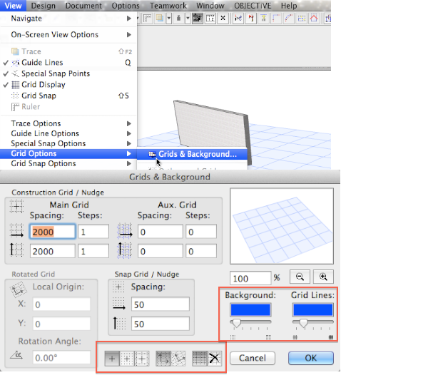

Try to reset the Grid & Background to default by:
1. Open 3D window, From menu, select "View" -> "Grid options" -> "Grids & Background.."
2. Change your setting according to default (use attached image for reference)
