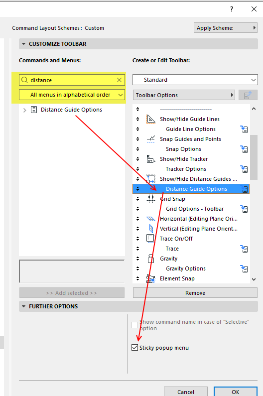

Hi all,
i don't know why i can't see DGs icon in the standard toolbar as a sticky pop menu in 27 3001 Ver. despite it was fine in 27 TP 2202 Ver. as attached screenshots.
If anyone know the reason for this pls guide me, thx in advance.

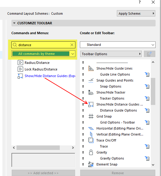

I just opened the AUS template and there seems to be nothing there at all in any of the Work Environments.
But it is easy enough to add.
And of course turn on the experimental feature.
And the result ...

Are you using a standard Work Environment in 27 (3001)?
If you are, maybe try another one.
Or you will have to edit the WE to add the pop-out menu.

Solution
And the result ...

Awesome explanation with those pictures above.
Thanks Barry, I tried for half an hour one time to try to find the drop down for the DG’s reference line option. I am glad it is still there.
