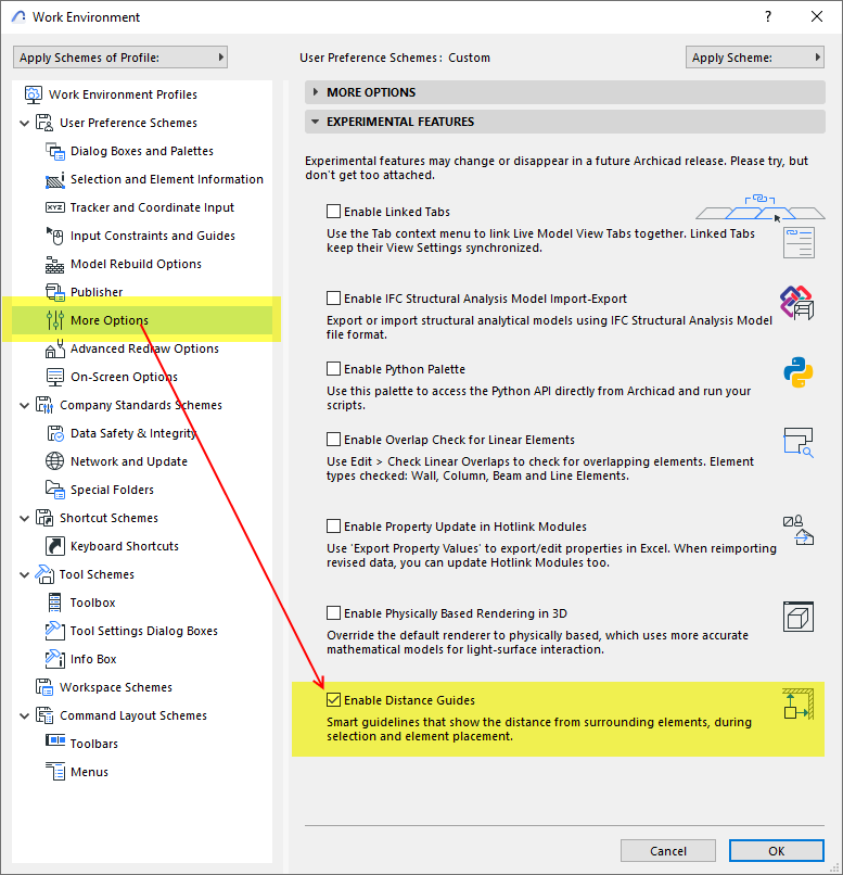

Hi all,
i don't know why i can't see DGs icon in the standard toolbar as a sticky pop menu in 27 3001 Ver. despite it was fine in 27 TP 2202 Ver. as attached screenshots.
If anyone know the reason for this pls guide me, thx in advance.

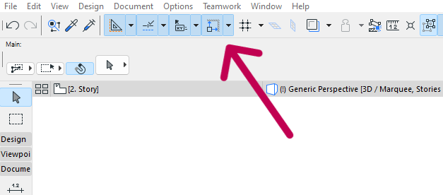

I just opened the AUS template and there seems to be nothing there at all in any of the Work Environments.
But it is easy enough to add.
And of course turn on the experimental feature.
And the result ...

Solution
And the result ...

Awesome explanation with those pictures above.
Thanks Barry, I tried for half an hour one time to try to find the drop down for the DG’s reference line option. I am glad it is still there.

That’s it Barry, I appreciate your efforts.
The only thing I find it old fashion and need some improvement is searching function in (Toolbars area), it is something hard and you should know how the command is named exactly and sometimes if you started searching by small letter gives you different results than if you started with capital one.
I feel that (Toolbars area)’s search mechanism should take some consideration from development team in order to be revamped as the new 20 search fields added or redeveloped in AC 27.
