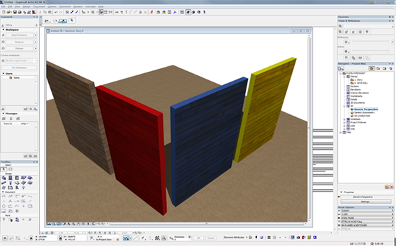

All wall's reference sides and opposite sides material are the same.
But when you change edge material something funny happens.
First wall on left has the same material on all sides.
The edge materials I've used on the other wall's has no texture or hatching.

Yes, I have and it is probably related to your videocard. Try updating the driver.

OK! I've got the latest driver installed but it's not always the latests who works best
I'll try an older one.

Hi Lasse
I have this happening to me too...
What graphics card are you using...?
Mine is an NVIDIA GTS 450 with latest drivers installed.
I am on windows7 64bit...
I am getting face specific materials choices not being displayed correctly in OpenGL mode but correctly in Internal Engine mode...
This happens with walls, slabs, roofs etc etc
I see a hotfix has been released for AC15... i will download and install and hopefully it might fix the issue...

I'm using a GeForce GTX 550 Ti with windows 7 64-bit
Unfortunately nor the 280.26 or earlier drivers worked so i got the beta 285.27 witch works fine.
Good luck!

Interestingly, if the archicad material has a texture assigned to it then it will display properly... If it is just a basic material like the 'paint 01,02,03 etc' default materials then there are display issues...
I am downloading the beta driver as we speak and will let you know if it fixes my side too...

All seems to be working fine now with beta version installed...
I hope that this beta driver, whilst correcting the Archicad display issue, doesn't affect any of my other 3d programs though!
