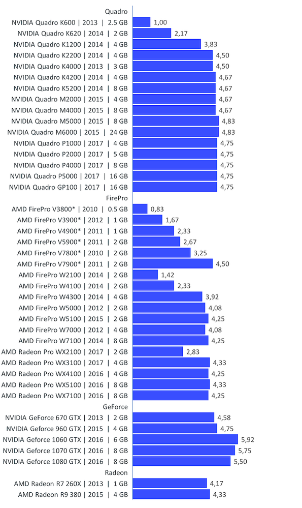

Video Card Tests Including 3D Speed
Here you can see the results how the different videocards have performed on a standard computer configuration with 4K display. The cards were tested with a small (250000 polygon), a medium (1,6M polygon) and a large (10M polygon) size project on two operating systems: Windows 8.1 64-bit and Windows 10 64 bit. The FPS number indicates a frames per second ratio based on the speed of Quadro K600 on Windows 8.1. Frame per second rate shows the speed of the Video Card measured while navigating in the 3D window of Archicad. The speed itself might depend mainly on the memory size of the Video Card. When we open a file and turn on 3D, the memory of the Video Card is used first, when it runs out then the Main Memory (RAM) is used, and finally when that is full, then the computer starts to swap the Virtual Memory. Using virtual Memory can be much slower than the others, because it takes time to reach the stored information from a file on the hard disk. Archicad stores the model information of the objects' parameters, and not by the coordinates of the polygons. Huge files that have a lot of parameters might occupy large amount of memory. And when the parameters of some geometry objects are set to large resolution or segmentation adds extra burden. Also there might be a model that itself is only just a few kilobytes, but its parameters would use up much from the Video Card memory with lots of large textures triggering slowness. This way it is not true that we can draw a paralell between the file size and the Video Card memory usage.
Test Results - Windows 8.1
The following video cards have been tested for Archicad 21 on Windows 8.1:
Small project (250000 polygon) - FPS ratio:

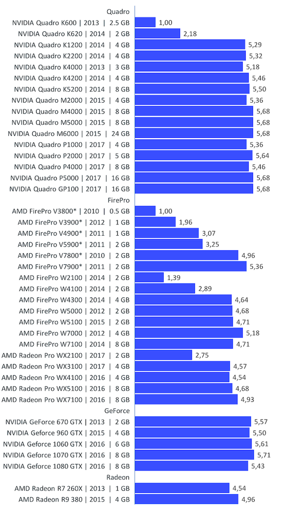

Medium project (1,6M polygon) - FPS ratio:

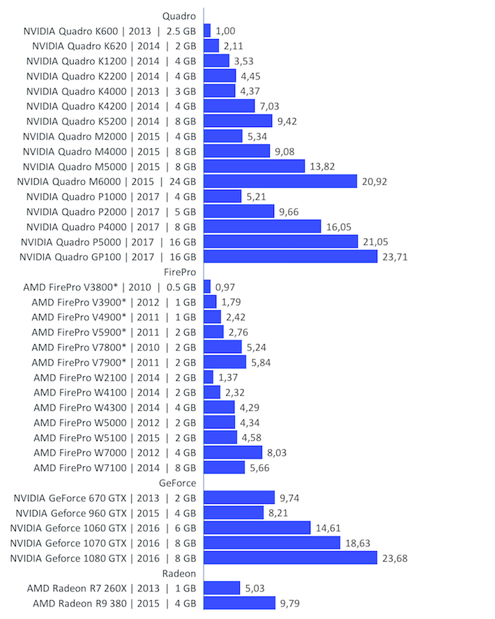

Large project (10M polygon) - FPS ratio:

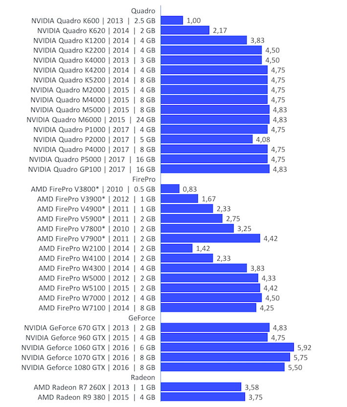

Test Results - Windows 10
The following video cards have been tested for Archicad 21 on Windows 10:

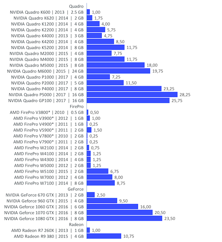

Video Cards tested for BIMx
Here you can see our BIMx results with different videocards. We used a quite complex model, the Shanghai Park Hotel, this can be downloaded from here amongst other BIMx ready Global Illuminated buildings. Tests were done on Windows 8.1. The Speed number indicates a frames per second ratio based on the speed of the Quadro 600 on Windows 8.1 with the full Global Illuminated model (with shadows on).
The following video cards have been tested for BIMx on Windows 8.1:
