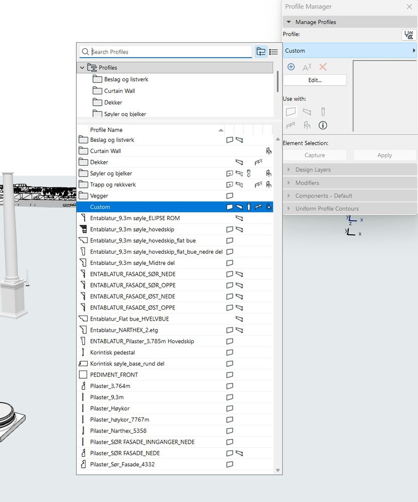

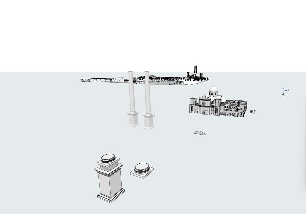

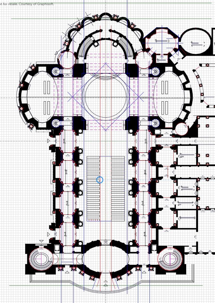

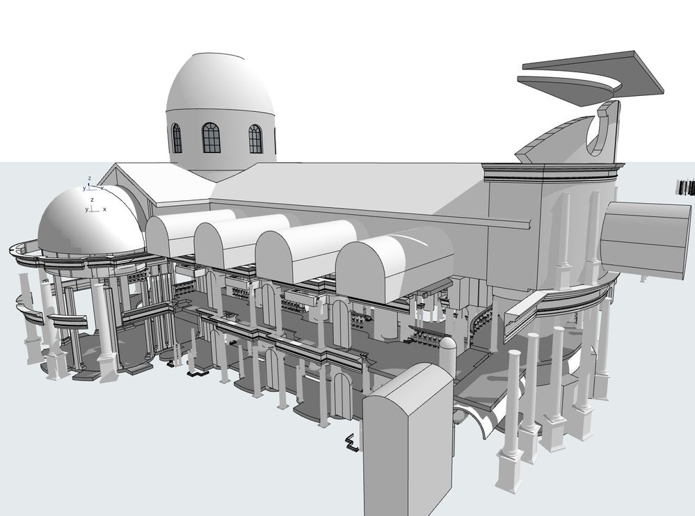

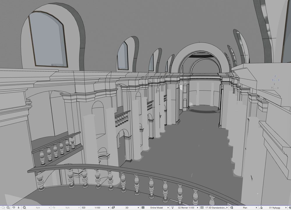

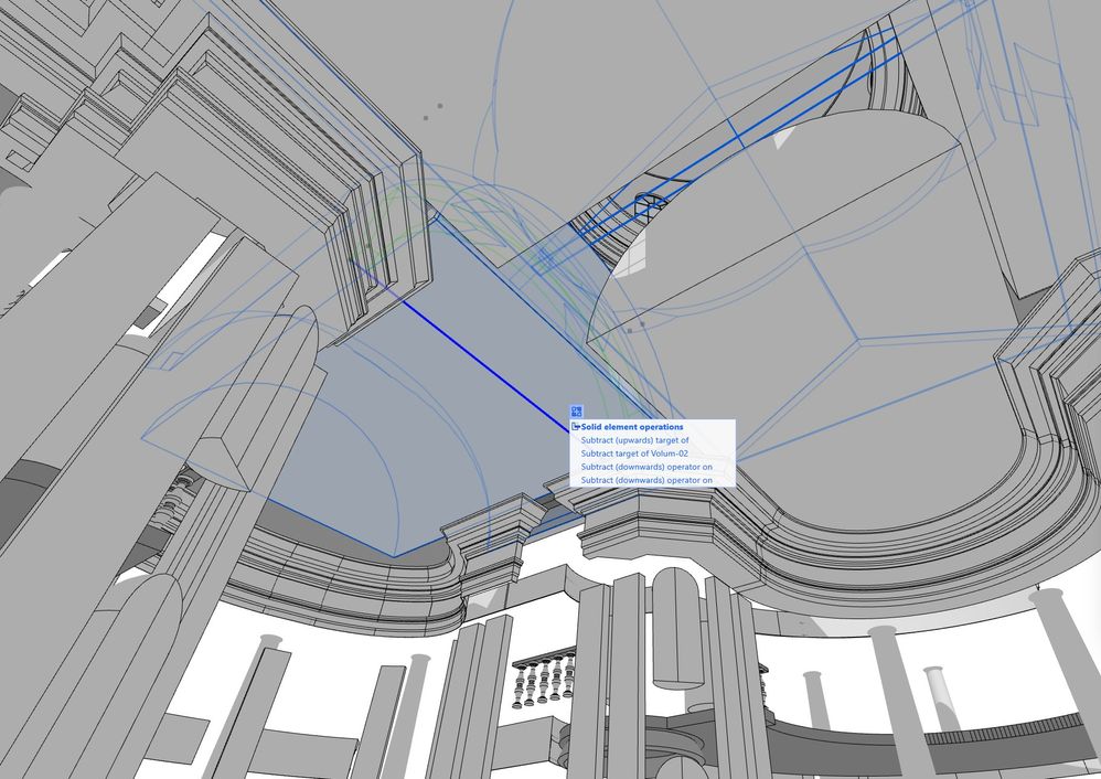

jonafa
First project: talked some of classmates above my year. When I said the landscape model came from Rhino they mostly shaked their heads, because according to them Archicad simply does not like Rhino 3D models. The landscape is not a mesh, but everything in it consists of objects (the model was given to us in the course by our teacher). I think that model is a bit of mess honestly, and another classmate who had the same course last year was also given the very same model. He said that file was a horrible to run.
As for the second project however which represent alot more the repeating performance pattern I am having in 2D, I can show you these  images which shows some the custom profiles and morphs that has been used. The image showcasing the SEO is one of the elements that has the most operations on it, its not alot actually. Looking at the floor plan, those custom made columns that you see along the nave of the church are incredibly slow to interact with, be it selecting and moving one when working in floor plan. Further the zooming in and out and navigating in the view is slow as well - sometimes the view freezes for a couple of seconds too.
MinhNguyen
from my past experience, there are 2 things that Archicad doesn't like in your case: complex profiles that are too complex (too curvy) and imported models with too many polygons.
The first one is easy, depending on your level of detail, don't include all the curves in the complex profile just because it will look nice. Segment them to straight lines whenever possible, and don't include too many components in one profile (I would say no more than 6 separated shapes)
The second one is more difficult as it is not something you can control. Have you try hotlink module workflow? Essentially you split the file into 2:
- Your working model
- Overall model/siteplan
You would import your working model into the overall model/siteplan for checking/rendering, but the actual design happens on a lighter file. This ensures that the stuff you're actually working on is not held back by redundant reference model that may not require constant manipulation.
Then there's an additional pro tips: if you only need the reference model in 2D format, try exporting that into PMK. It'll help immensely, although I didn't know about this until I started working at an architectural firm
BIM Manager - DKO Architecture - Archicad 28 on Windows 11
