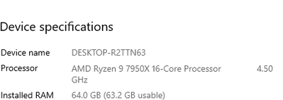

I have a new pc with windows 10 and OpenGL doesnt work with AC24
 Open GL doesnt work properly it says openGL isn't working
Videocard NVIDIA Geforce RTX4070
Please Help
Operating system used: Windows 10
4 Replies 4
Archicad may not be using the dedicated video card.
In the operating system settings, check whether Archicad is using the integrated GPU of the processor, and if it does, set it to use the dedicated video card.
Lingwisyer
Guru
Just because I just heard someone mention it recently, you are plugged into the GPU and not the Motherboard right?
GershonPocorni
I found the solution, the motherboard wasn’t up to date
Lingwisyer
Guru
That is odd, as unless you are using the integrated, it should not be handled by the motherboard...
