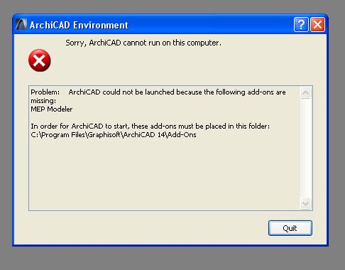

I get, after installing the latest hotfix (AC14-3477-HOTFIX2-WIN32.exe), the following error message:
Problem: ArchiCAD could not be launched because the following add-ons are
missing:
MEP Modeler
In order for ArchiCAD to start, these add-ons must be placed in this folder:
C:\Program Files\Graphisoft\ArchiCAD 14\Add-Ons
I have never added MEP-modeler to Archicad 14, but I had the trial version in AC13 but was never able to use it (no available license).
After getting the error message after the hotfix I downloaded and installed MEP-modeler for AC14 - same error message. I then uninstalled MEP-modeler but still get the same error message.
Please advice!
Thank you in advance!

I finally got AC to start again!
I uninstalled the latest hotfix by using the repair function on the install DVD, and now AC is starting up again. I guess I'll stay away from the hotfix for now...
