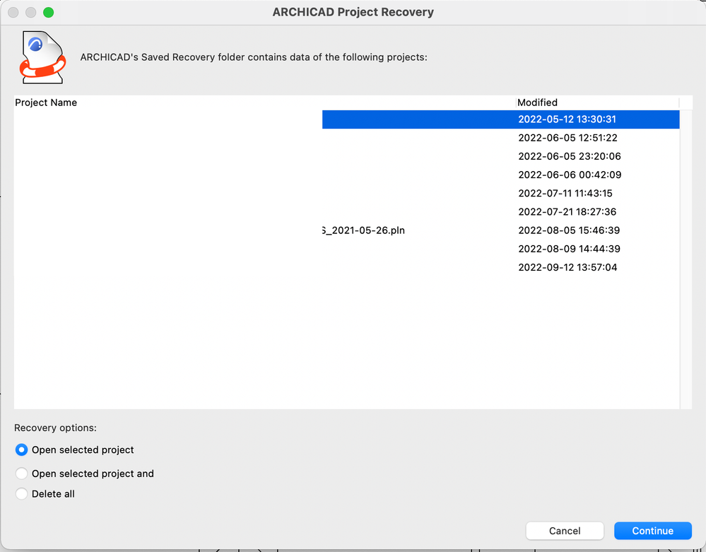

Hello i'am using Archicad 24 on MAC, when I launch Archicad new instance File>New> launch new instance, the recovery file window doesn't pop up. To some colleagues it's the same and to others there is no recovery window as well, the only option is to close Archicad completely and relaunch to get the main window with recovery files. I wonder if this is a bug or maybe could have to do something with work environment, at this point I don't know anymore.

I do launch new instance, but on some computers we get this recovery window ( by doing the exact same steps ) and on some like mine this window doesn't pop up.

I am sorry I made a mistake while typing the topic, what I meant was this window that pops up, not recovery files themselves.

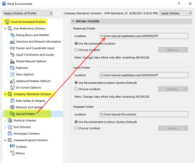

As I mentioned, make sure all running copies of Archicad are shut down before restarting.
I am not familiar with Macs, but in Windows we have a task manager where we can close running applications.
Also check your Work Environment to see where your temporary files are being saved.
If you go to that location, you should find the auto recovery folders ("Archicad_number") - do you have access?
They will delete automatically when Archicad is shut down properly and should remain if Archicad crashes or is force to quit.
Again this is Windows, not Mac.
