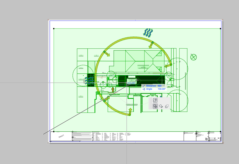

Resize frame and move frame problem - snaps to corner
Ellen
Hi!
I'm having a new (previously not encountered) problem with view resizing and reposition on my sheets. When I click move or re-frame any of the views on my sheet, archicad autosnaps to something, seemingly the corner of my sheet. I set up about 10 sheets yesterday, re-sizing and moving things around within the frames and didn't run into this problem.
It's not isolated to this file either, I have another instance of Archicad open, and it now doing it that file as well.
The screenshots attached show what happens when I click to move or resize the frame, you can see the spot it want to attach everything to.
I have restarted archicad, both instances of the program, and restarted my computer. I've done a quick internet search but I'm not sure I'm accurately describing the problem to get the right how-to-fix.
Your help is greatly appreciated! I'm fairly stuck at the moment!

It could maybe be a grid snap issue? You may accidentally enabled it? (Alt-S is the default shortcut)

Amazing, thank you this worked! I would have never figured this out or figured out what to search for to fix it.
