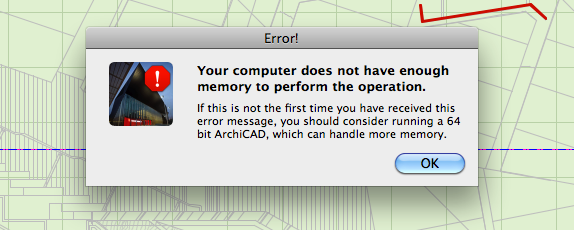

I was working on a file on my MacPro without problems, after switching to the Macbook Pro for a meeting with the client I got the following error…

I would switch to the 64 version of AC but there is no Mac version.
BTW the error is given in section and elevations, not in the 3d window or stories.

Apparently not the same bug. The problem is not the 3D window or the renderings its elevations and sections. But if I had AC64 for Mac I would not have this problem.

Tried it, no joy, section screen size does not affect it. FWIW I know what is causing the error it is an imported 3ds, if I turn it layer off it works without problems.
I just find it ironic that the solution to the problem as stated by the error message is to use a version that is not available for the Mac.
