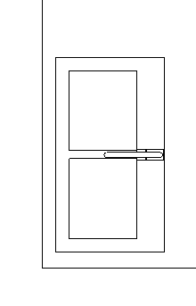

I have inserted this tap (Tap 23) in my model. I can see it in the stories plans but it is not visible in 3d or in the sections. I can select it though. The 3d representation is set on "Full", the layers are all turned on, the 3d elements filter is also ok. What could it be?Captura de tela 2022-02-01 141227.pngCaptura de tela 2022-02-01 141250.png

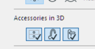

You will also need to check these settings in the MVO...
The middle one is taps.
