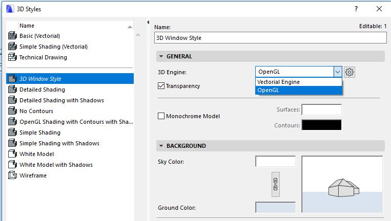

A colleague has installed the 5010 update, and now when she goes to 3D window there is no Open GL option. In the 3D Styles dialogue there is only the Vectorial Engine option available from the drop down 3D Engine setting for all styles. Is this a bug or should she run the update again? Or go back to the previous (3009) update?

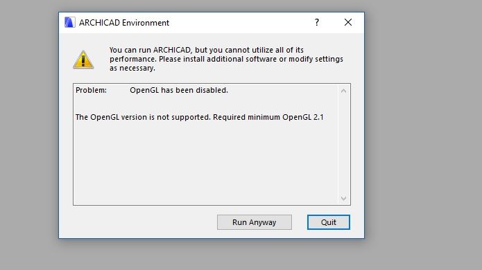

I'm wondering now if it is specific to the file itself, or to a particular computer. The file has this issue on a couple of computers here, but not mine, and other files work OK for everyone. On one of the machines where it did not work we got an "OpenGL has been disabled" error message (attached).

For me it turned out to be a problem with the video drivers installed on my HP ProBook 6470b with an Intel HD Graphics 4000 video card. With the default (and latest, officially supported) driver from HP, which is 9.17.10.4229 (26.05.2015), I got the "OpenGL has been disabled" error, though the OpenGL version supported by this driver is 4.0 (I verified it also with a third party tool).
The solution was upgrading the driver manually using the guidelines from Intel: https://www.intel.com/content/www/us/en/support/articles/000005629/graphics-drivers.html. With the latest driver 10.18.10.4653 (07.04.2017) it seems to work now, I can select and use the OpenGL option in the 3D-Engine dropdown menu.
