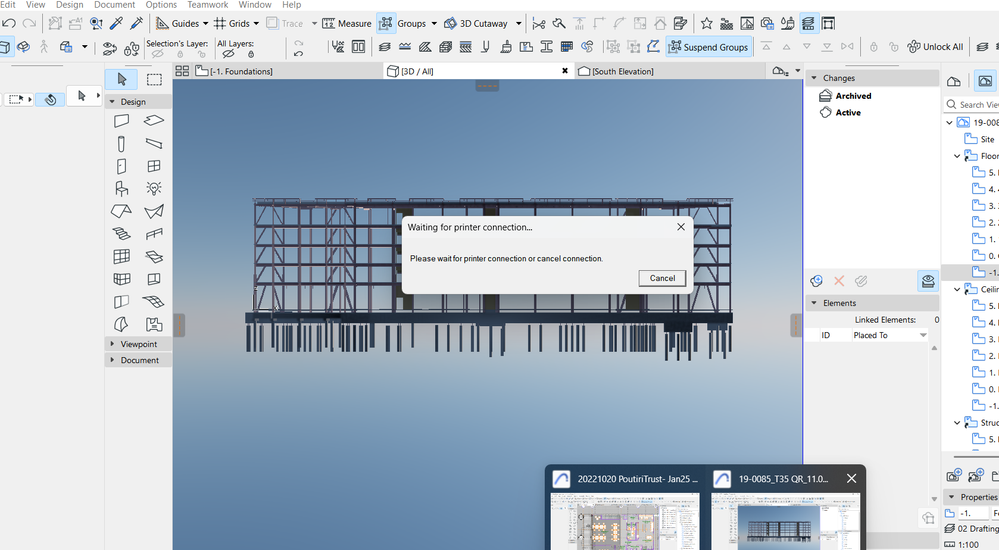

Just a bug heads up to the devs - not sure if this is the correct place to post.
I get a recurring prompt upon opening the ArchicadStarter as per the title and screen grabs below. Every time I select 'open project' or double click from the list BEFORE this prompt displays, the project will never open - it's a 100% occurrence. The cursor will just blue cycle until I force quit. If I cancel the prompt and then double-click open a project quickly it will open with no problem; if I wait a few more seconds until just before the same prompt shows up again, it will freeze again as above. Perhaps it's a Windows printer issue, but probably something GS should get onto as it disrupts the working day.
More recently a crash prompted the same message at the bugsplat window and it was unable to finish sending (or so it appeared) and I was unable to cancel out.
It 100% happens every time I start Archicad so I'm happy for a dev to get in touch and work through diagnostics for a solution.

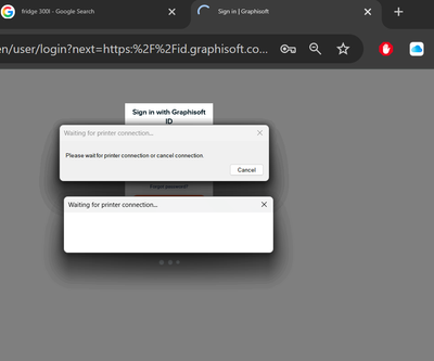

The issue with modern working setups ie. from home and office. Im often at home away from the work printers - which will be offline in my printer list - and deleting them is not an option as i will eventually return to the office and need to print.
Latest crash picking up door settings in an internal elevation:
I'm not sure the crash report ever goes through.
Which is probably why this BASIC BASIC PRINTER issue still persists.
