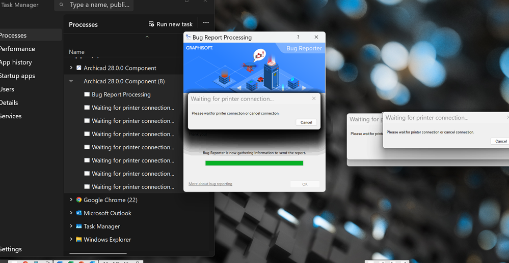

Just a bug heads up to the devs - not sure if this is the correct place to post.
I get a recurring prompt upon opening the ArchicadStarter as per the title and screen grabs below. Every time I select 'open project' or double click from the list BEFORE this prompt displays, the project will never open - it's a 100% occurrence. The cursor will just blue cycle until I force quit. If I cancel the prompt and then double-click open a project quickly it will open with no problem; if I wait a few more seconds until just before the same prompt shows up again, it will freeze again as above. Perhaps it's a Windows printer issue, but probably something GS should get onto as it disrupts the working day.

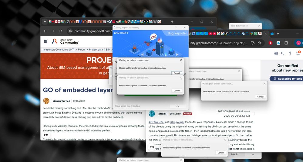

More recently a crash prompted the same message at the bugsplat window and it was unable to finish sending (or so it appeared) and I was unable to cancel out.
It 100% happens every time I start Archicad so I'm happy for a dev to get in touch and work through diagnostics for a solution.

This is still fun in AC28 @Oleksandra Vakariuk
I'm not convinced the error report is going through, which im sure you can agree is starving GS of much needed data to resolve bugs.

I hope so. But i've left it 24 hours before and still the green progress bar doesnt reach the end and automatically close as you would expect.
I have to force close in task manager.
The printer issue (for which i have tried everything to resolve) seems to be interrupting the bugsplat process.
Again i hope it isnt fully interrupting the information from being sent.

The previous suggestions REDUCED the incidence of getting the message, in-fact the message was eliminated at the ACStarter project selection, but persists when closing or crashing.
And when i say persists, the message can show up to 50 or so times and positions itself where the cursor is, leaving one heck of a mess on the screen until force closed.

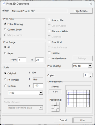

If I go to FILE menu > Print, the default printer is 'Microsoft Print to PDF' - is that the same for you?
My process is the same: always publish, never print from within AC, and have never touched the print settings, so yes default is Microsoft Print to PDF.

So after a while as per my post above, with "let windows manage my default printer" the annoying pop up is back at the bugsplat when AC crashes, and prevents the diagnostic information from sending out. Pleeeeeease fix it

Still an issue on 28.0.2 (3110) NZE FULL
It doesnt matter which default printer options i choose in Windows OS Settings, this intrusive bug still occurs when AC crashes.
