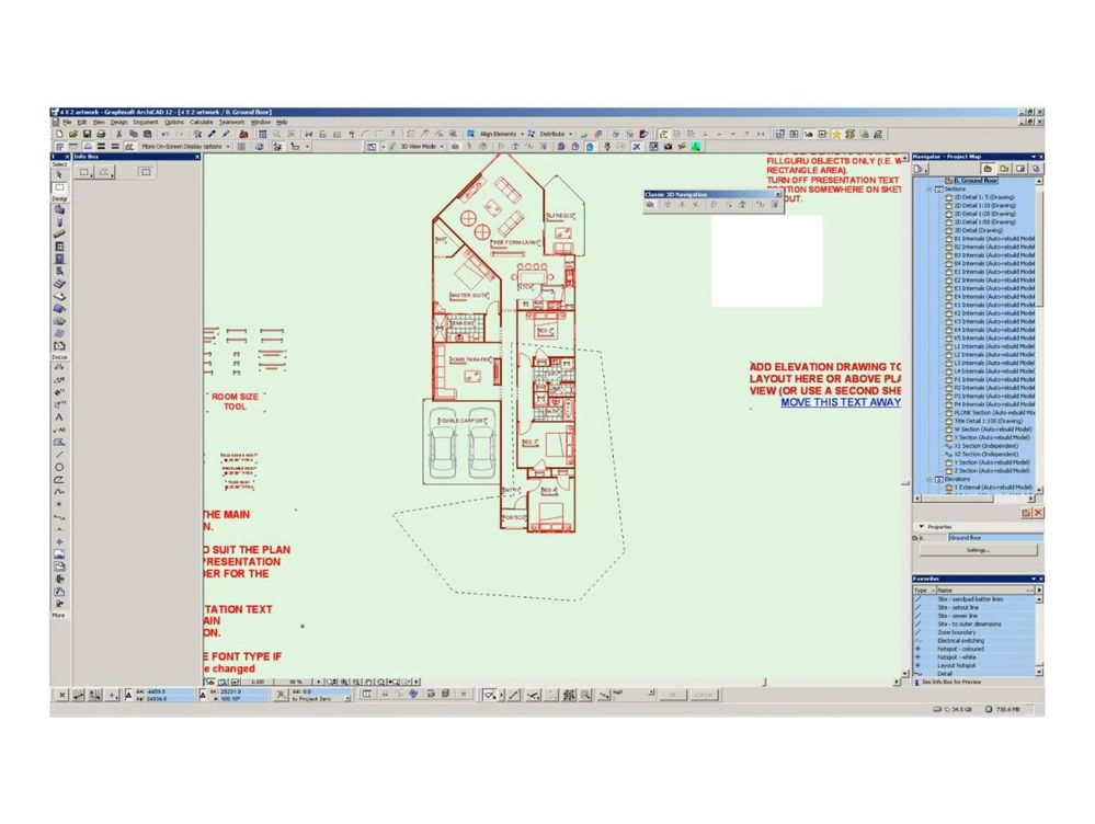

Here is an image with the marquee before the stretch.
