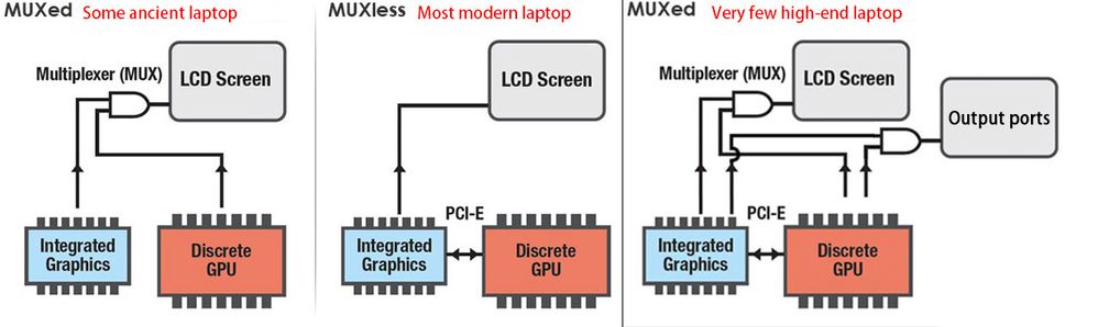

however this round i bought a content creator laptop. and have learned that just about every new laptop that's not directly related to gaming comes as a muxless system, simply put you can not switch to just the dGPU if you are using the laptop screen its not possible. thus unless you use an external monitor there is no way to avoid the screen flicker.
so to anyone buying a new laptop, if you don't want to deal with the screen flicker, make sure the laptop is muxed, not muxless.
I tried everything i could find to help the issue and unfortunately not even tricking the computer into thinking its attached to an external monitor will resolve the issue.
muxless laptops always use the integrated gpu for everything on screen that is not 3d and will render all 3d items with the dGPU and becasue the dGPU has to go through the iGPU on the laptop screen the flicker will happen.
hopefully intel and NVIDIA/amd can find a way to make things better with the graphics switching.
There is not a loss in performance, but the flicker can be pretty annoying lol.

Sorry, but what is this "mux", "muxed", "muxless"? Never heard of this word before.
What's more, not even ChatGPT could help me with its meaning.
Botonis
Mentor
Archicad users don't need AI.....!!!!!!!!!!!!!!!!!
Just kidding!
Civil Engineer, Enviromental Design MSc. BS ArchitectsVR.
Graphisoft Insider Panelist-Archicad 29. Windows 11. Intel Xeon 2699x2,64 GB RAM, Nvidia ny or personal website3080Ti. 2 Monitors.
OK, thanks, now I understand MUX - Multiplexer.
So, I have one question left: when looking at laptop specs, where or what in the specification do I have to look to see if a laptop is a MUXed or MUXless system? Is this something that depends on the chipset? Or the motherboard design? Or something else?
I have not ever seen it listed. I only found out once I started trying to figure things out. I noticed it in my bios.
I would guess you could chat with the mfg and have them tell you.
But other than that I'm not sure how you would know.
