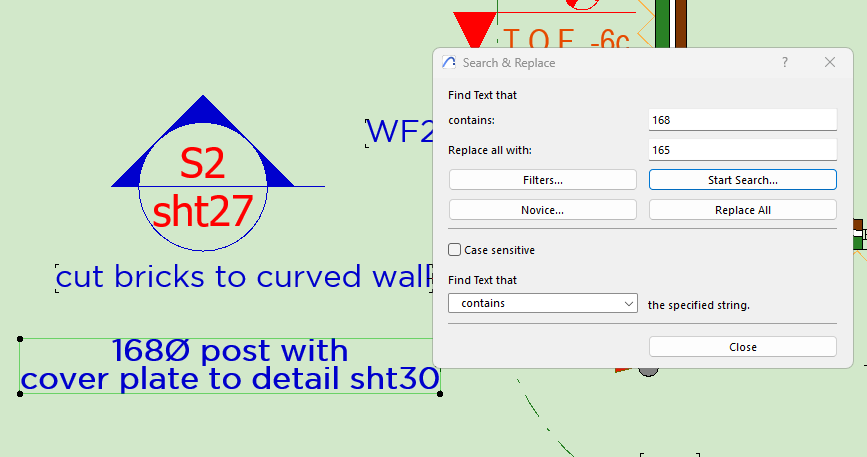

Why would this search return no results?

@Too Long ,
Make sure your Archicad is up to date.
This seems to have worked for others.
Thanks Barry, Im at 28.3.1. and still no result.
AC26 AUS Full
The last message I had from tech support was that it didn't work with text that had auto text in it.
I see your text seems to have a drawing number - possibly that is autotext?
But I just tried some text that has autotext in it, and that worked for me.
The only thing is I am on build 28.3.0
I will update a little later and will try again.
It also will not look at locked text or locked layers, but your text does not appear to be locked.
Does your search say there is no match, or does it just not do anything?
Yes, there is auto text in this label though even if a place a label containing only the search text it still produces no results. But it does work with text.
The return I get is "There is no matching text".
what Ive noticed is that associative labels cant be selected within the filter field. This label is associated to the post so this may be the issue. why you wouldnt associate a label befuddles me though. and the only way to make this option selectable is to check the "include uneditable elements" which again befuddles me because how could this be helpful aside for highlighting the text that is required to be changed manually which really defeats the purpose.
AC26 AUS Full
So yes, its associated labels. these cant be edited in this manner.
AC26 AUS Full
Associated labels can be edited so long as you include them in the filter.
It just can't alter any autotext element of that text label - i.e. the size or sheet number.
Fantastic. Confusing that it is listed under Uneditable Elements and it can be edited.
AC26 AUS Full
