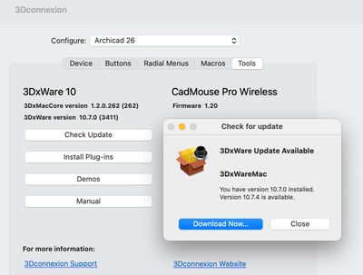

Jeff G
I use a 3DConnexion SpaceNavigator on a Mac (running macOS Ventura) with Archicad 26 USA Full. I experienced issues (I don't recall what they were exactly) with the latest 3DConnexion drivers, so I uninstalled the new drivers and installed version 10.7 and things are now working well.  I'd suggest you try the same. Version 10.7 can be downloaded from here: https://3dconnexion.com/us/archived-drivers/?fwp_drivers_os=macos-12
