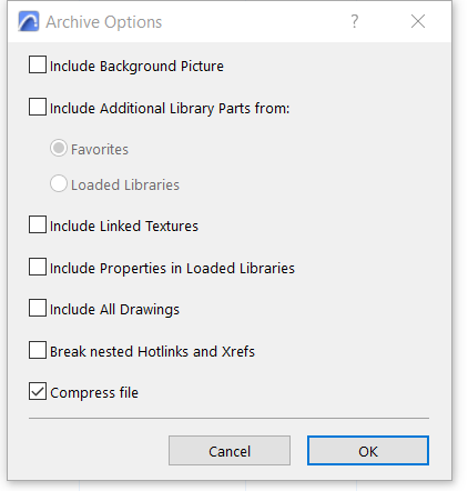

Correct, I was thinking in percentage and forgot to write "%". I will try the settings.
AC27 INT | WIN10
qingdom
I unchecked everything except compress file, the filesize still around the same 1.7 GB (it reduced by 150 MB 😂).
What else can i do?
PS: This didn't happen in earlier versions, usually it just doubled.
