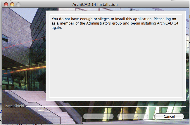

I downloaded everything successfully from the web but once I try the archicad installer an error of administrator privileges comes out. Look at attachment. If anybody knows what I can do pls reply.

seems as if you do not have enough privileges to install something in the choosen location.
for instance on a mac you need to be setup as admin in...
system preferences > accounts > allow user to administer this computer
... to be able to install apps.
please provide more information (mac/pc, your own computer, etc. ?), so someone might be able to help you.
