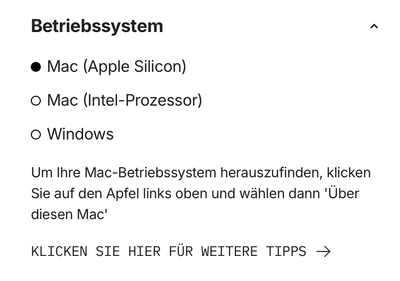

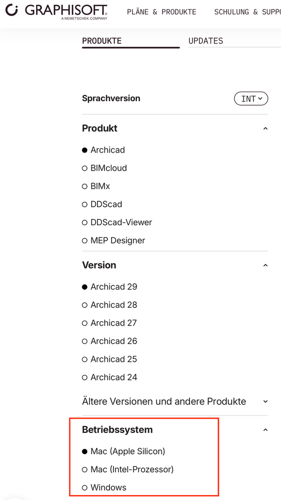

Andreas81ch
Graphisoft Download Page;
ArchiCAD v6.5 - 28 (CHE Swiss Edition) - macOS / WIN (Switzerland / Schweiz)

Solution
Yes, AC will work on both the new silicon Mac and the old Intel Mac, and you don't have to worry about lost license on older Intel Mac.
You can have ArchiCAD installed on as many computers as you want, even on different systems (win, intel mac, silicon mac). However, you can only work on the computer on which you have downloaded the license via the GS License Manager Tool (or possibly on the computer with the USB hardware key), but you certainly understand that I think.
Here is the compatibility table https://support.graphisoft.com/hc/en-us/articles/38519356625937-Archicad-Compatibility-MacOs
