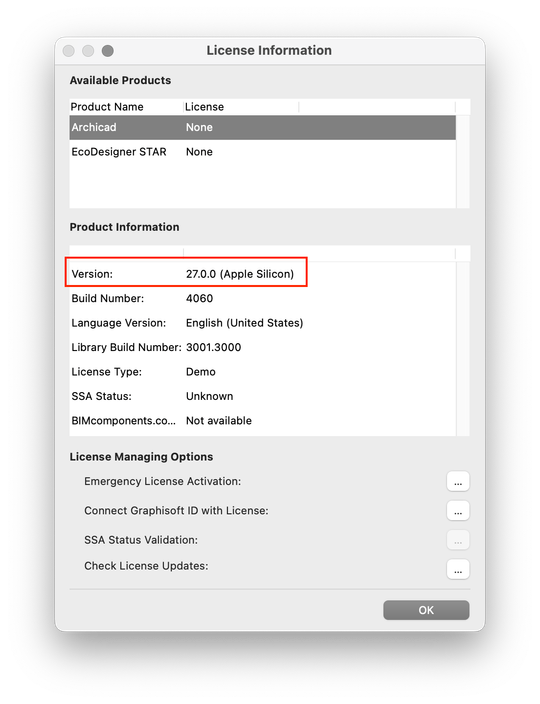

I'm pretty sure yes.  The installation file is still in my downloads folder and it says 'ARM'.
Is there any way to check once it's installed?  When I check the 'about archicad' it shows version 3001 but doesn't mention anything about ARM...

Eduardo Rolon
AC current version is 4060 so that might be the real issue since slowness was a previous bug.
If you open Activity Monitor it will show under "Kind" if it is the ARM version,

Jeff:
The License Information db has this information.
