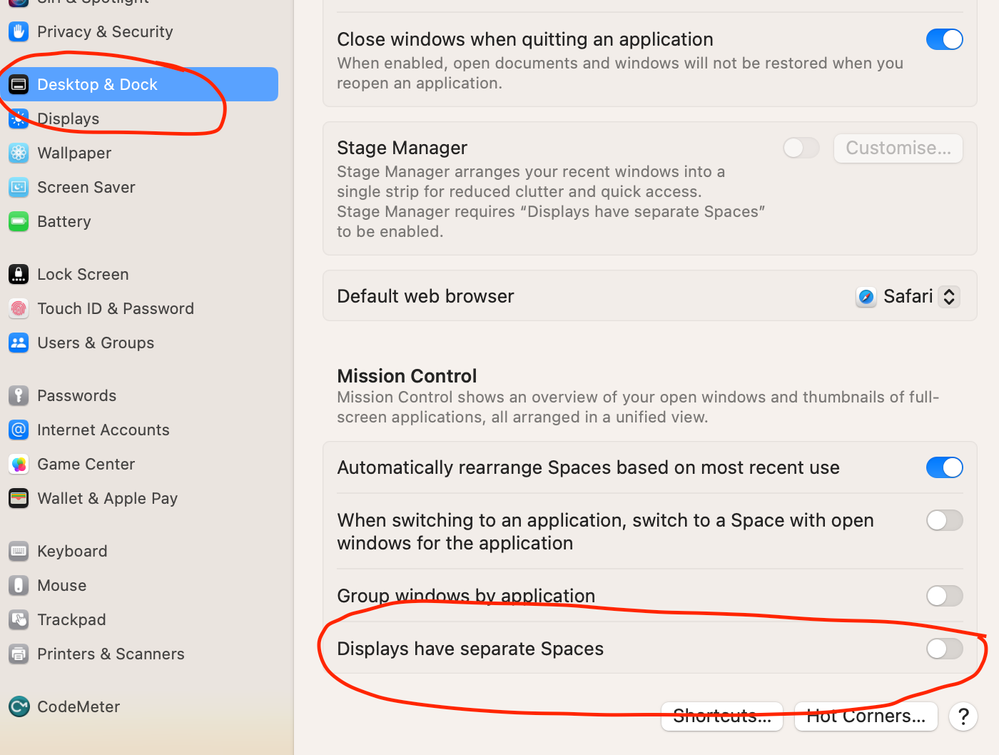

Have you updated your printer driver? Also if you uncheck the options for your second screen to act as a space if its on that may resolve your palette issue.

Where are you seeing the display option check box?  I don't see it in WE?

If you go to System Preferences then select 'Desktop and Dock' from the side menu and then scroll to the bottom and uncheck 'Displays Have Separate Spaces', this may overcome your palette issue.Screenshot 2023-01-13 at 11.05.46.png

Thanks for the suggestion but it made no difference.. I think 🙂  I opened a file and the Drawing Manager was missing.  I changed the setting/logged out/in etc.. no difference.  I then put the setting back to separate spaces (logged out/in).  Opened the same file and it showed up.  Maybe my OS is haunted.

Just FYI, turning this setting off also disables Stage Manager.
