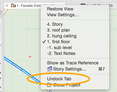

Eduardo Rolon
You must have undocked the window by mistake and once undocked it will remain like that until you select to "Dock All Windows" from the Window Menu.
