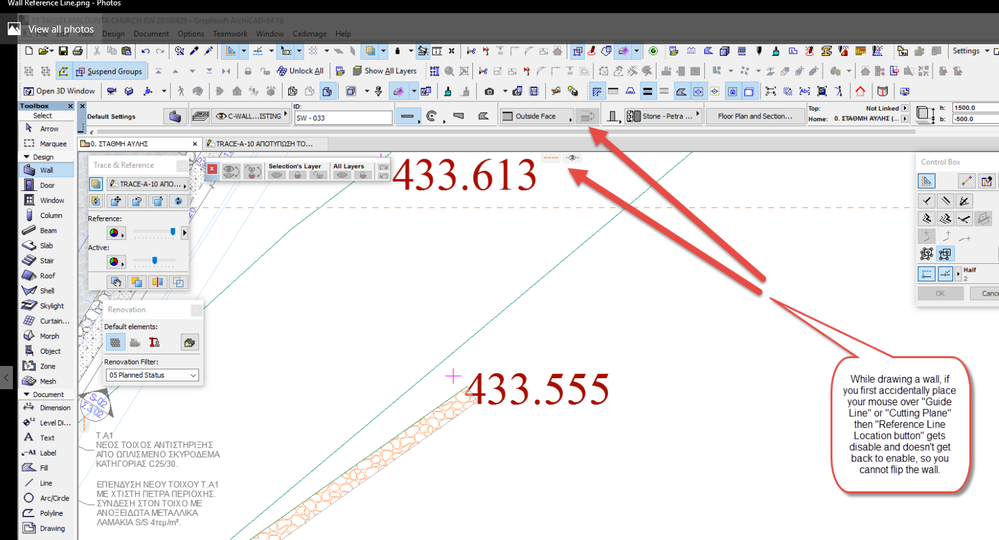

Hi, I have this problem:
While drawing a wall, if first accidentally pass my mouse over "Guide Line" or "Cutting Plane" then "Reference Line Location button" gets disable and doesn't get back to enable, so I cannot flip the wall.
I have to press escape and pick again to draw another wall.
(See attachment)
Archicad 19 build 5005
Windows x64 via Bootcamp.
MacPro Late 2013

You are not alone on this one. Indeed I never figure out why this was happening, but now that you just say it I went and realize that, that is the problem, when you pass the mouse by Guide lines, this happens. And also is still happening in AC20, just tried.
While this is solved, when drawing walls in chained method, you can click to create the first wall, then hit backspace to go back one click and the option will become available again.

Katalin Borszeki
Hello Takis,
Thank you for your report about this issue, we’ve added it to our database and plan to fix it in the near future.

Try the P and C keyboard shortcuts.
Don't be controlled by the Wall Reference Line
