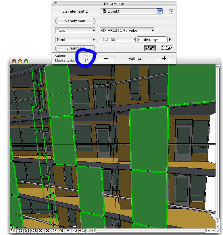

Warning; Bad BUG in Find tool
There is a bad bug in the Find tool when selecting objects
in 3D-view -> seems that the tool is zoom dependent and
excludes everything outside the current view.
(Archicad version Mac / FIN1010)
See examples;

Hello Laszlo,
It's a bad bug in my opinion…zooming should not have anything
to do with this dialog box.
There is a separate choice for "Selected area inside/outside"
why not "Zoomed area" then?
In addition the tool works differently on windows and objects.
