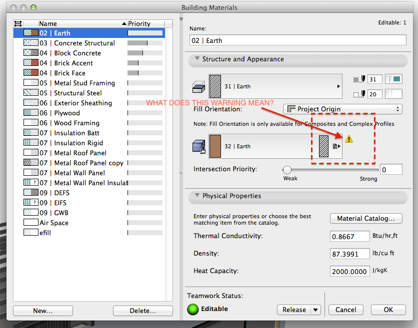

You still have "Legacy" mode on so in fact you are using surfaces and not seeing the building materials.
You can turn it off in Options menus > Project Preferences > Construction Elements...
It will be on by default for any file created in version 16 or before.
