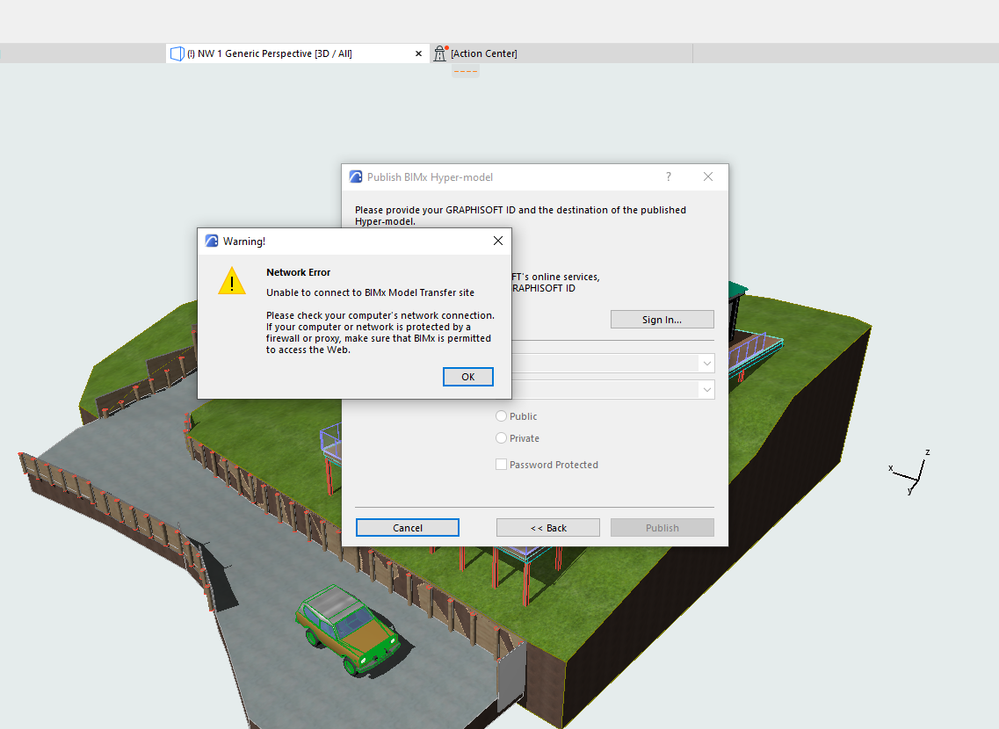

dslightfoot
Network error
Trying  and load the BIMx Hyer-model (sign in) comes up with Network error
help pls
Try installing the security update mentioned here ...
https://community.graphisoft.com/t5/Installation-update/Security-Update-for-Archicad-22-25-and-Licen...
