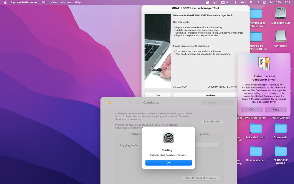

codemeter problem -Failed to start CodeMeter Service) AC 25 macos Monterey
Does anyone know how to fix the CODEMETER issiu so I can get it to start running - Macos Monterey 12.6.1  ?

Try downloading and installing the latest codemeter driver. That often fixes a lot of these sorts of issues.

I tried and updated macos but still can’t start running codemeter.

I would suggest completely uninstall Codemeter first. There is a guide on Community here: https://community.Graphisoft.com/t5/Setup-License-articles/How-to-uninstall-reinstall-CodeMeter-driv...
After that, reinstall Codemeter again. If it doesn't help, your best bet is to contact the local support for further checking.
