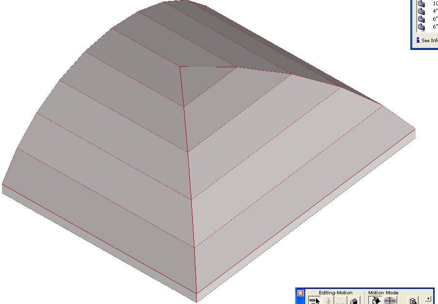

We all understand how wonderful it is to create a vaulted roof in ArchiCAD. But, I have an existing building where the end bays of the rectangular plan, are vaulted at 90º. (like a rounded gabled roof - or 1/2 of an eliptical dome)
Can this consrtucted in ArchiCAD simply? or must it be done with the mesh tool?

something like this?

For my needs yes that system could do - actually the 90º turn is built a little softer...ie. as an elliptical dome form..but your concept is a wonderful alternate that I may use as this is not paramount for nothing other than as a reference. on the drawings. and would never show in any 3D sketches.... Many Thanks.
Dwight
To clarify my method:
This is made from one segment of a dome built automatically from roof bits. The segment elements are stretched, cut down into a quadrant form, then mutiplied around.
It would be simple to add one more step - that of a corner truncation.
Post a photo of what you are trying for....
Dwight Atkinson
perhaps this will help....the existing roof is as if the vault was rotated arount its center line for the last bay.. Thanks
Upps !! ...try this picture...
Is this what you are looking for?
